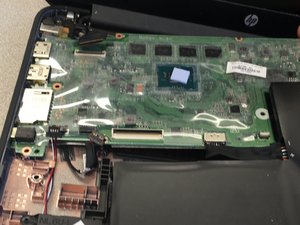

+[title] Remove system board and battery
+[* red] Locate the plastic clips/tabs that are holding the system board down. There are 2. One by the battery and one by the left-side hinge.
+[* black] Carefully lift upward from the right-side the battery/system board all at the same time. You will need to lift it up and press in the first tab, and pull it out to the right.
+[* black] Set the system board and battery off to the side.
