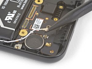

+[* black] Use the point of a spudger to pry up and disconnect the white antenna cable from its socket.
+[* black] Carefully route the antenna cable out of its retaining clips.
