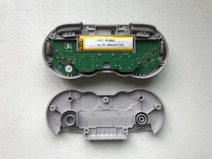

+[title] Lift the Back Panel
+[* black] Lift the back panel, starting along the top edge of the controller.

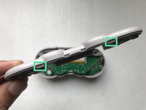

+ [* green] There are two notches along the bottom edge that help keep the front and back panels together. This will be useful during reassembly.
