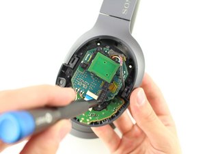

+[* red] Using the J00 Phillips-head screwdriver, remove the two 6.4 mm screws holding the NFC chip in place over the mother board
+[* black] Once the screws are removed, gently turn over the board to the left to expose the soldered connection points.
