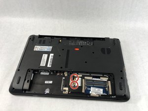

+[* red] Locate the black and white antenna wire connectors.

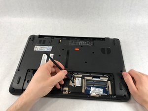

+[* black] Using a plastic spudger lift and disconnect each connector.
