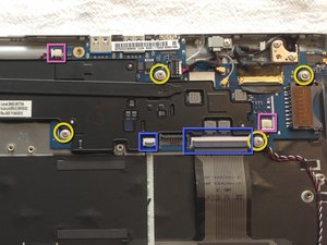

+ | [* black] Battery removed, it's now time to remove the screen and pull the main board |
+ | [* red] Disconnect the 2 antenna lines from the main board |
+ | [* orange] Disconnect the screen cable |
+ | [* yellow] Remove the 5 screws holding the main board |
+ | [* green] Probably a good idea to disconnect the remaining 4 cables as well |
+ | [* blue] Keyboard and mouse ribbon cables |
+ | [* violet] Audio cables |
