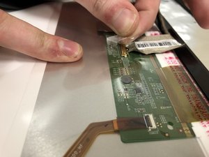

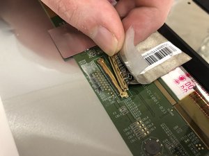

+[* black] Locate the small ribbon cable attached to the back of the screen.
+[* black] Carefully removed the clear adhesive tape holding the cable down. Being very careful not to damage the small wires under the tape.
+[* black] Once the tape has been removed, the ribbon connector will pull away from the back of screen.
