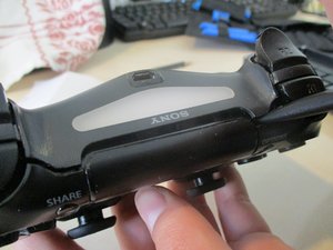

+[* red] Unscrew these 4 PH0 Screws to open the back cover.
+[* black] Carefully pry around the cover with a spudger. Pull the back part to open the enclosure.

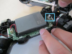

+[* icon_caution] Be careful not to pull too far though, because there is a fragile connector connecting the light bar assembly.
+ [* light_blue] Disconnect the light bar ribbon cable.
