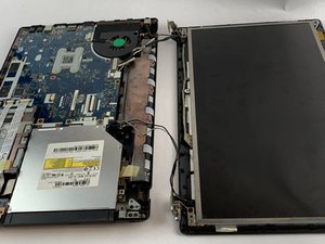

+[* red] Unscrew the two bottom screws on the both hinges to separate the screen from the rest.
+[* icon_caution] The computer is still connected to the backside of the motherboard so do not yank it off completely.
