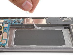

+[* black] Remove the battery.
+[* black] Do not reuse the battery after it has been removed, as doing so is a potential safety hazard. Replace it with a new battery.
+[* icon_reminder] Before you reinstall a battery, be sure to remove all traces of adhesive from the frame.
+[* icon_reminder] ''Temporarily'' re-connect the battery to the motherboard before sticking the battery in place. This ensures proper battery alignment.
