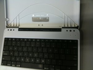

+[* black] Open the case and remove the 2 stickers at the top of the keyboard. This will reveal the 6 screws that attach the upper cover to the keyboard cover.
