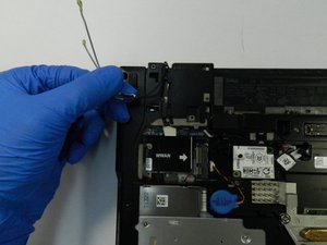

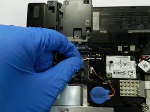

+[* black] Take the silver panels from both sides of the back of the laptop by removing the screw using a type 0 Philips head.
+[* black] slide the silver panel away from you to revel some wires.
+[* black] Remove the two wires white and gray by gently pulling up and detaching them.
+[* black] After the wires are detached, gently pull the wires away from you to remove them from the groove they are in.
