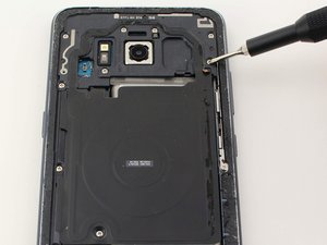

+[* red] Remove thirteen 3.5 mm screws using a Phillips 00 Screwdriver.
+[* orange] This screw only needs to be removed if you want to access the volume up/down and Bixby keys. It is not necessary to remove this screw to remove the iris scanner.
