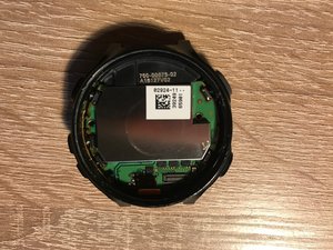

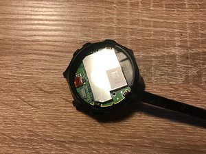

+[title] Remove the main board
+[* black] Two T6 screws hold the mainboard to the body.
+[* black] The main board will move from where the Spuder is inserted.
+[* black] Remove the green protective tape and disconnect the second ribbon cable before proceeding.
