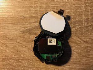

+[title] Prise off the front
+[* black] The front is glued
+[* black] Use an iFixit Spuder to prise around the glue. It's not necessary to use a heat gun here.
