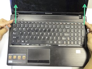

+[* green] Grab the keyboard at the corners and pull the keyboard off the laptop.
+[* icon_caution] Make sure to disconnect the cord connecting the keyboard to the laptop before removing the keyboard.
