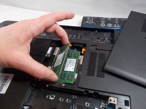

+[* black] Remove the memory module
+ [* black] Push the silver levers on either side of the memory module away from the module.
+ [* black] Remove the memory module by gently pulling it on an angle away from the slot
