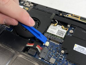

+[* black] Next locate the cable connection to the lower right hand side of the fan as shown in the photo.
+[* black] Use the plastic iFixit tool to remove the cable connector from its housing.
