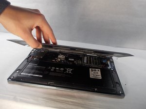

+[* icon_caution] Ensure computer is unplugged and powered down before continuing.
+[* red] Locate and remove 10 screws around the base using a Phillips #000.
+[* black] Use a Plastic Opening Tool to pry open the base .
