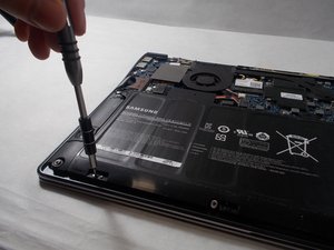

+[* black] Locate the 6 screw that are holding it in place and use the (insert screwdriver type here) to remove the screws.

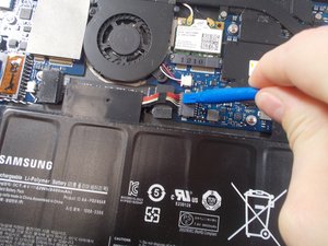

+[* black] Before fully removing the battery use the <plastic hook tool> to detach the ribbon wire cable the connects the battery to the motherboard.
