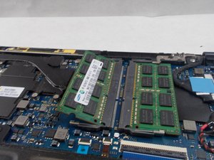

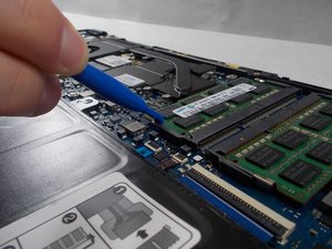

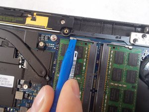

+[* black] First use a platic lever tool to nudge one clamp holding one stick of RAM outward. If done correctly the clamp should move away from the stick of RAM. Do this with the clamp on the opposite side of the same stick or RAM. The stick of RAM will pop up when both clamps are released
