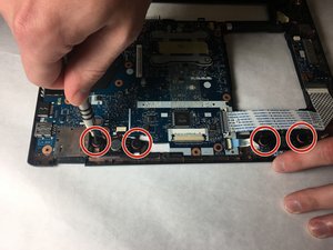

+[* red] Locate and remove the 4 speaker screws. They are #00 and 3 millimeters in length.
+[* icon_note] To distinguish these screws from the others, these screws have an especially large diameter head.
