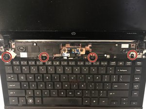

+[* black] Flip over and open the laptop.
+[* black] Remove the now loosened cover by grabbing both sides and sliding up.
+[* black] Remove the four 3mm Phillips head black screws directly above the keyboard.
