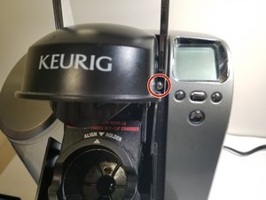

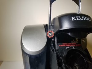

+[* icon_reminder] Be sure to use a Multi-Bit Magnetic Screwdriver and a S2 T-15 screw tip for this step.
+[* black] Open the lid of the Keurig to access the first set of nails needing to be removed.
+[* icon_note] These nails are located on both the lower right and left side of the metal handle.
+[* black] Take your screwdriver and turn to the left to remove both sets of nails.
