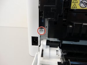

+[* black] Lower back panel
+[* red] Remove one Philips 10mm screw

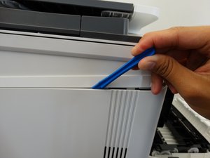

+[* black] Use plastic opening tool to remove right side panel
+[* icon_note] Flipping the printer onto its side makes it easier to remove the side panel
