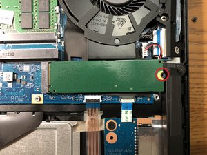

+[title] Removing the fans
+[* black] Remove the two screws from both fans. Disconnect the connectors. Do not pull cooling system away yet.
+[* black] Remove your SSD by taking the one screw out. Lift straight up, and the SSD will come out.
