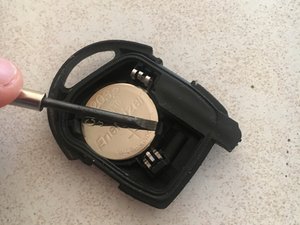

+[title] Inserting the new battery
+[* black] Now that the old battery is out, to insert your new battery push back with a tool on one of the clips to give space, then slide it in.
+[* black] Make sure the battery has postive side facing up. The battery when I opened my key was a CR2032.
