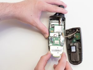

+[* black] Carefully use spudger to lift the PCB a few centimeters.
+[* black] Pull the PCB out towards the bottom of the GPSMap 60CSx.

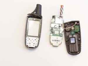

+[* icon_note] This will pull out all the main components including the antenna and the screen.
+[* black] You will now be able to work with the front panel without it being attatched to the rest of the GPSMap 60CSx.
