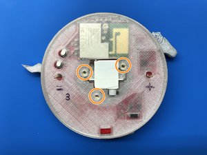

+[title] Assemble back of enclosure
+[* black] Start by placing the bottom (notched) into the bottom lip of the enclosure.
+[* black] Align all three mounting holes.
+[* black] Press firmly (avoid putting pressure on horse) around the edges until the back presses flush with the outside edge.
+[* black] Drive three M2 screws into place. DO NOT OVER TIGHTEN!
