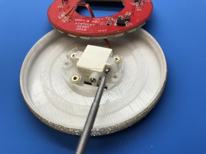

+[title] Mount servo

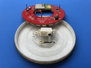

+[* black] Pull the servo through the middle of the PCB.
+[* black] Orient the servo arm to the left (aligned with the rest of the body). This should be at one endstop.
+[* black] Manually move the servo arm down 90 so it is now facing the enclosure.
+[* black] Mount the servo to the enclosure
