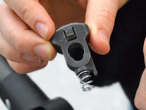

+[title] Remove old part
+[* black] Push the old button, and place the flathead screwdriver behind the button
+[* black] Push the button down and towards the opening of the cylinder.
+[* black] Take out the wheel lock button and the spring, and make sure not to lose the spring.
