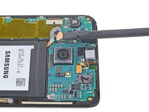

+[* black] Using the flat end of a spudger, disconnect the battery ribbon cable from the motherboard.
