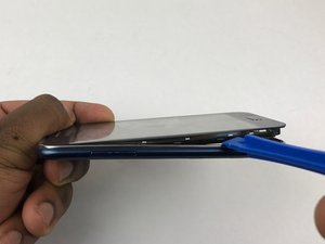

+[* black] Insert a plastic opening tool between the screen and the back of the device.
+[* black] Starting at the bottom of the device, gently slide the tool along the edges of the screen.

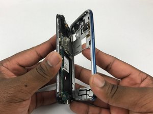

+[* black] Gently pry the main assembly from the back housing of the device.
+[* icon_caution] When removing the main assembly, pry gently so as to not crack the glass screen or break any clips within the device.
