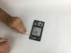

+[* black] Disconnect lower PCB cable connections and antenna.
+[* black] Remove haptic motor at bottom left of the device. This will require a prying tool and the motor is glued to the device.
