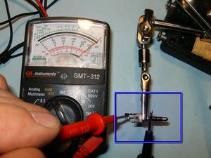

+[* red] Ring (middle) of the connector and the medium size tab showed continuity, therefore a match.
+[* blue] Last Sleeve (top) and the longest tab showed continuity. Now it is determined which parts are a match. this is important to properly connect the left and right speaker (driver)
+[* black] If no multimeter is available, here is a quick sketch about the three corresponding connections.
