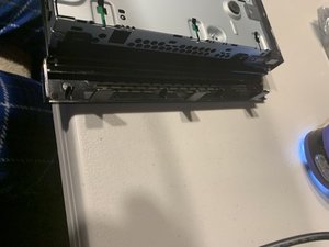

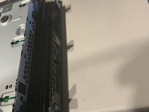

+[title] Pry up on side retainers and remove the top cover.
+[* black] On each side under where the side covers were there are two retainers that hold the top cover to the sides.
+[* black] Lift up on these retainers and the one rear retainer (to the right of the component outputs) and the whole cover should come right off.
