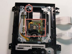

+[* black] Unhook the left bar in the area circled by pushing the bar to the left, lifting up and then pushing to the right.
+[* black] **Make sure the drive lens is pushed back toward the black wheel, as indicated with the big red square.
