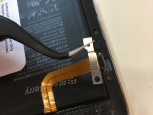

+[title] Remove Battery
+[* black] Use extreme caution when removing the battery. It is directly against the motherboard, and piercing the battery could corrode other components. It could also catch flame.
+[* black] Take off the battery shield, and use a scalpel or other flat tool to remove the foam on the connector. Place these onto new battery.
+[* black] Carefully apply some low heat to the stickers covering the battery and gently peel them off. The white sticker is connected to adhesive under the battery.
+[* black] Gently pry up on the edges of the battery so that the adhesive will come out more easily. Take great care not to pierce the black "skin" on the battery.
+[* black] Slowly start pulling the adhesive tab out, regripping close to the battery as it starts to come out.
