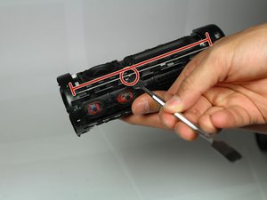

+[* black] Using the metal spudger, specifically the pointy end, find the gap between the speaker and billow.
+[* black] Pry the metal wire up and out at exactly this gap, then slide down wire towards one end to pop it out completely.
+[* black] Once one end is out, use fingers to gently pull off completely, so as not to bend the wire to aggressively.
