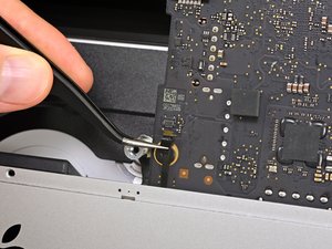

+[* black] Flip the latch on the microphone [guide|25629|ZIF connector|stepid=64969|new_window=true] and pull the cable out of its socket on the logic board.
