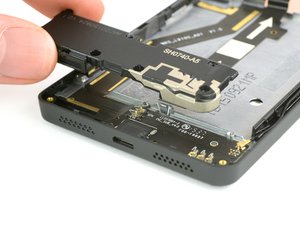

+[* black] Insert the flat side of a Spudger into the gap on the right side of the loud speaker unit.
+[* black] Lever the lout speaker unit up with the Spudger, you just inserted.
+[* black] Grab the loud speaker unit and take it out of the phone.
