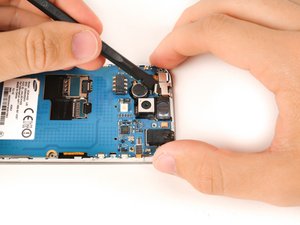

+[* black] Use the flat end of a nylon spudger to lift the infrared sensor press-fit connector up to release the ribbon cable.
