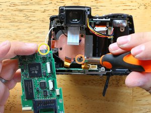

+[* red] Push the locks up to release the lens servo motor cables. Gently remove the cables out of their sockets.
+[* orange] Unscrew the #00 Phillips holding a grounding wire against sensor shield.
+[* yellow] At this point, you can choose to cut or de-solder the white wire from the board. It is the remote flash sync wire.
+[* icon_note] The main board is now completely detached from the chassis and can be safely removed.
