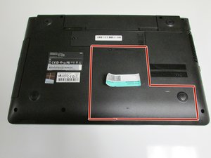

+[* black] Locate the ODD/HDD/Memory panel on the backside of laptop.

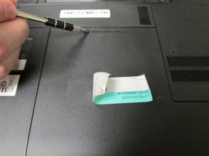

+[* black] Using the Phillips #1 screwdriver, remove the M2.5X5 mm screw out to take the back cover out.

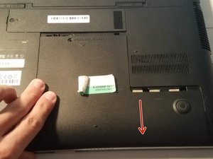

+[* black] Using your hand slide the ODD/HDD/Memory panel off in a downward motion.
