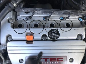

+[* black] Once clips are removed,
+[* black] Pull the Plugs out and place them in order the way you have pulled them out.
+[* black] You should see 4 holes where the spark plugs are located.
