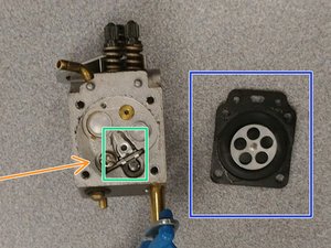

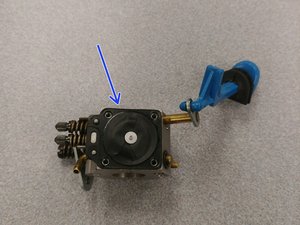

+[title] Carburetor Disassembly (Lower Cover)
+[* red] Remove the four screws holding the diaphragm cover plate then remove the plate
+[* blue] Remove the diaphragm and its seal from the carburetor
+[* orange] Remove the screw holding float set and needle valve
+[* icon_caution] Be careful the float set is under spring tension
+[* green] Remove float set and needle valve
