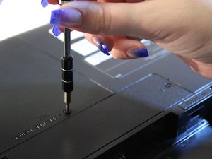

+[* black] Locate the ODD/HDD/Memory panel.
+[* red] Remove the screw located on the ODD/HDD/Memory panel with the Philips PH0 screwdriver.

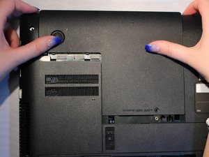

+[* black] Slide the ODD/HDD/Memory panel away from the device to remove it.
