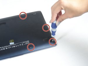

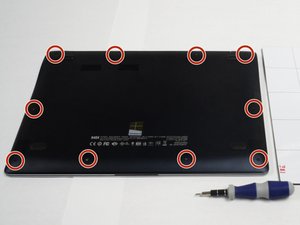

+[* black] Locate the 10 screws around the edges of the cover. Using a Philips head screwdriver, carefully unscrew the 4.3 mm Phillips #000 screws located on the edges and corners of the laptop.
