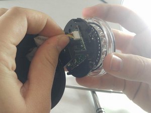

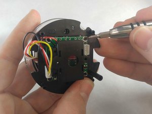

+[* black] With the camera in hand, the circuit board must be separated from the LED containment shell. There is a 5mm Phillips #J0 screw at every corner of the circuit board. The wires attaching the circuit board to the shell should be removed as well.
+[* black] These screws are small so be careful not to drop them on the floor or you may lose them.
