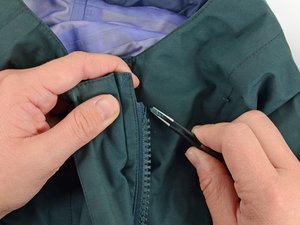

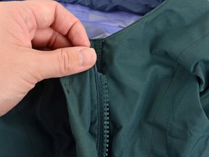

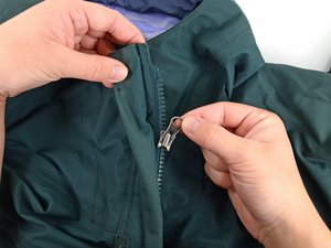

Replace the Slider on a Plastic Tooth Zipper
Introduction
When a zipper pull breaks, or the slider simply wears out, you don’t need to replace the entire zipper. Just replace the zipper slider. This is a quick repair that can make the difference between a zipper that doesn’t work at all and one that works like it’s brand new.Determine the size of your replacement slider by looking on the bottom of your existing slider
